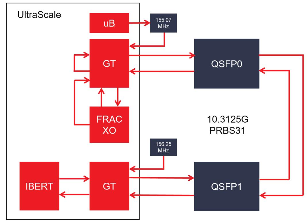

Below is a simple block diagram for the reference design used to measure latency on the U200.
Transceiver Latency Evaluation Block Diagram

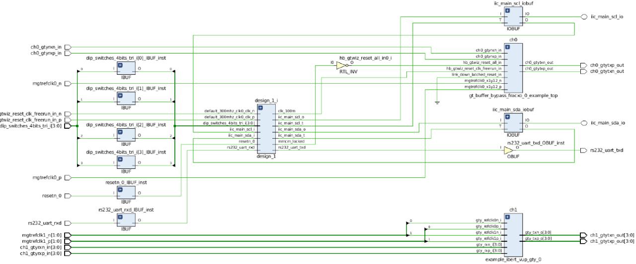

Producing the HW reference design
  • Create FRACXO example design from IP default configuration @ 10.3125G.
  • Create GT wizard example design @ 10.3125G/155.075187M with same configuration as FRACXO example design.
  • RX and TX buffers bypassed and reset, buffer bypass, and clocking helper blocks in example design.
  • Copy and paste FRACXO related items from FRACXO example design into GT wizard example design.
  • Disable PRBS generator, wrap RX data to TX data, and make TXOUTCLK master of TXUSRCLKs/RXUSRCLKs.
  • Set RXSYNC_SKIP_DA = 1'b1 in xdc to operate RX as a slave and skip delay alignment.
  • Put FRACXO on QSFP0 Quad 231 - use Silabs programmable Si570 clock on refclk0.
  • Add IBERT design on QSFP1 Quad 230 - use default 156.25MHz on refclk1.

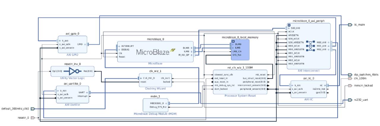

  • Add MicroBlaze processor subsystem with i2c peripheral to control Si530 refclk0.
Block diagram of HW reference design
Block Diagram of MicroBlaze reference design

  • After bitstream generation in the Vivado 2019.1 tcl console export dsa with write_dsa -fixed -include_bit u200.dsa
  • Open the Vitis software platform and create new SDK Application project using the u200.dsa.
  • Modify i2c si570 c code found in XAPP742 to adapt to the U200 to program to QSFP0 GT to 155.075187 MHz.

First, the U200 was checked for good signal integrity from QSFP0 to QSFP1 via a copper 1m QSFP cable.  IBERT results along with a picture of the test setup are shown below.  Note that the default configuration of the U200 results in QSFP0/1 refclk1 being set to 161.1328 MHz.  A simple run-time setting on IBERT (if generated for using 156.25 MHz) to adjust the QPLL divide factor from 66 to 64 was necessary to get the desired 10.3125G line rate.
IBERT Test of U200 from QSFP0 to QSFP1
Alveo U200 Latency Test Setup
Using the Alveo test setup above the design was verified via JTAG.  Vitas was used to program the SiLabs Si570 part to 155.075187 MHz.  Note that the HW manager snapshot below shows a single channel of 10.3125G IBERT traffic looping from QSFP1 through the QSFPO error free retimed by FRACXO. The ILA capture shows the FRACXO status showing low error and voltage indicating lock.  If FRACXO was not locked, and adequate timing margin did not exist in the fabric with the transceiver in buffer bypass, data would not be able to pass error free.  This validates the complete design with all features for ultra low-latency.

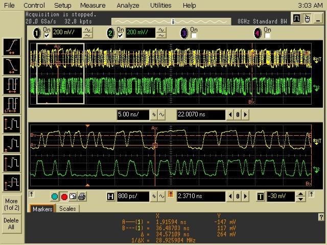

The latency scope measurements were obtained on an internal evaluation board due to available SMA connections to make the measurement.  While these same measurements could have been done on the Alveo u200, the QSFP breakout boards required were not available at the time of this write-up.  Regardless, the latency measurements will be identical on any UltraScale Plus transceiver.

32-bit data width buffer bypass
Calculated latency:
  • TX = 32+32+32+16+29 = 141 UI
  • RX = 52.5+16+32+32 = 132.5 = 133 UI
  • Total = 274 UI = (274)*1/10.3125G = 26.570 ns
Measured latency:
  • Used a PRBS9 to measure RX-TX roundtrip latency since pattern is 511 UI (49.55ns) so it doesn't repeat during GT delay.
  • Scope measurement (looking for 9 ones pattern) delay is 34.5ns.
  • Calculate board and cable delay.
  • Samtec 24in cable assembly HDR-155805-01-BEYE delay ~4.72ns/m. So cable delay is 39.3701in/m /(24in*2)/(4.72ns/m) = 5.75ns
  • UC1262 Q124 TX = 2990 mils Q124 RX = 2730 mils ~ 160ps/in. So PCB delay is (2.99 + 2.73) * 0.160ns = 0.9152ns
  • Total Board+cable delay (not accounting for scope and misc adapters - bullets, dc blocks, bnc to sma) = 6.6698ns
  • Total TX+RX roundtrip delay measured = 34.5ns - 6.6698ns = 27.83ns
32-bit data width latency measurement

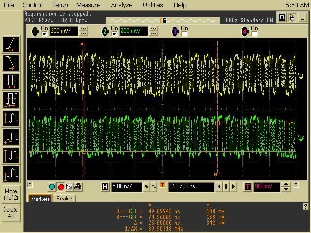

20-bit data width buffer bypass
Calculated latency:
  • TX = 20+20+20+10+19 = 89 UI
  • RX = 42.5+10+20+20 = 92.5 = 93 UI
  • Total = 182 UI = (182)*1/10.3125G = 17.65 ns
Measured latency:
  • Scope measurement (looking for 9 ones pattern) delay is 25.1ns.
  • Subtract out fixture delays as above.
  • Total TX+RX roundtrip delay measured = 25.1ns - 6.6698ns = 18.43ns
20-bit data width latency measurement

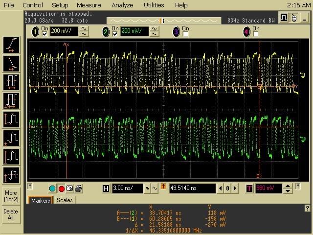

16-bit data width buffer bypass
Calculated latency:
  • TX = 16+16+16+8+19 = 75 UI
  • RX = 36.5+8+16+16 = 76.5 = 77 UI
  • Total = 152 UI = (152)*1/10.3125G = 14.739 ns
Measured latency:
  • Scope measurement (looking for 9 ones pattern) delay is 21.50ns.
  • Total TX+RX roundtrip delay measured = 21.5ns - 6.6698ns = 14.83ns
16-bit data width latency measurement
