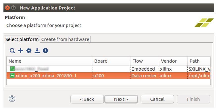

From the Vitis IDE we create a new Application Project (e.g. File > New > Application Project…).  After naming the project you’ll be asked to select a platform.  Which platforms are available will depend upon which board-specific packages that were installed.  Since we installed packages for the U200 at least this platform should be available, in addition to possibly some pre-installed defaults.
New Application Project

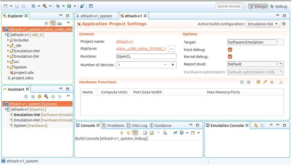

Moving forward with the U200 platform selected we then choose to create the “Vector Addition” example.  Once the application is created the project should resemble the screenshot below.
Project
Although we could’ve started with an empty application, choosing the vector addition example will allow us to leverage the supplied host code.  OpenCL involves a fair bit of boilerplate code, so it’ll be nice to not re-write that.
