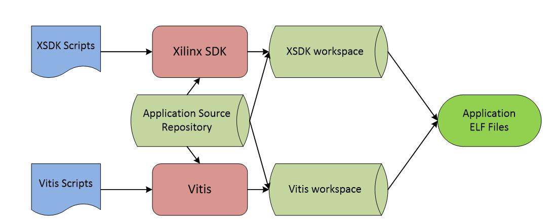

The diagram below illustrates the two flows with the upper portion covering Xilinx SDK (i.e. pre 2019.2) flow and the lower portion covering Vitis (i.e. 2019.2 and later). Each flow operates on the same application source repository (but a unique hardware design file). Each uses a set of scripts tailored for the respective toolset and produces a workspace corresponding to the toolset. From the workspace, the ELF files can be obtained (unlikely to be identical between the two flows).
xilinx-sdk-and-vitis-tool-flows-to-produce-elf-files-from-the-application-source-archive
The application source repository is common to both flows. It is expected that prior to running either flow all the source files are set to the desired version and made available to be read by the scripts or tools. The organization of the repository is detailed below, the basic structure is a folder for each application with each containing that application’s source files, linker script, and MSS file. The MSS file contains the information necessary to generate the BSP.
