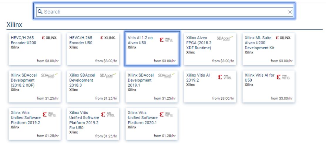

  2.  Select ‘Xilinx Vitis AI 1.2 on U50’ – if necessary, use the Search box.
vitis ai 1.2
Tip: If you don’t see something that looks like the above image, try clicking on the ‘Compute’ button.

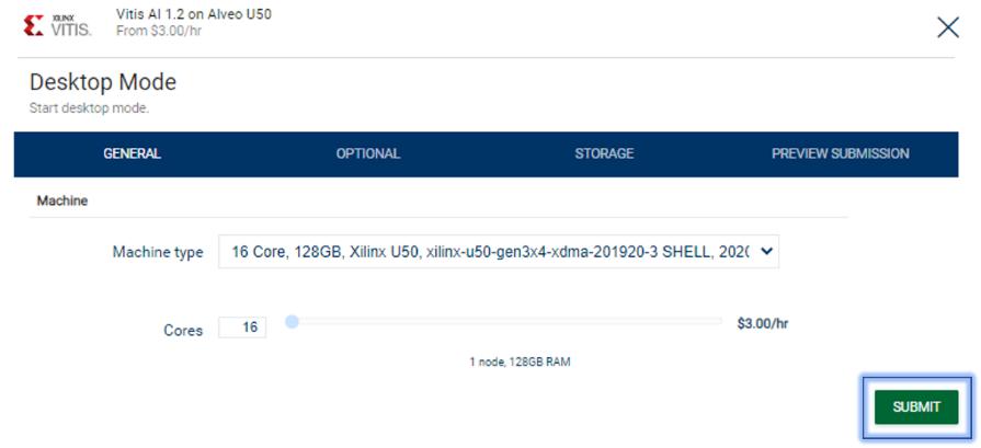

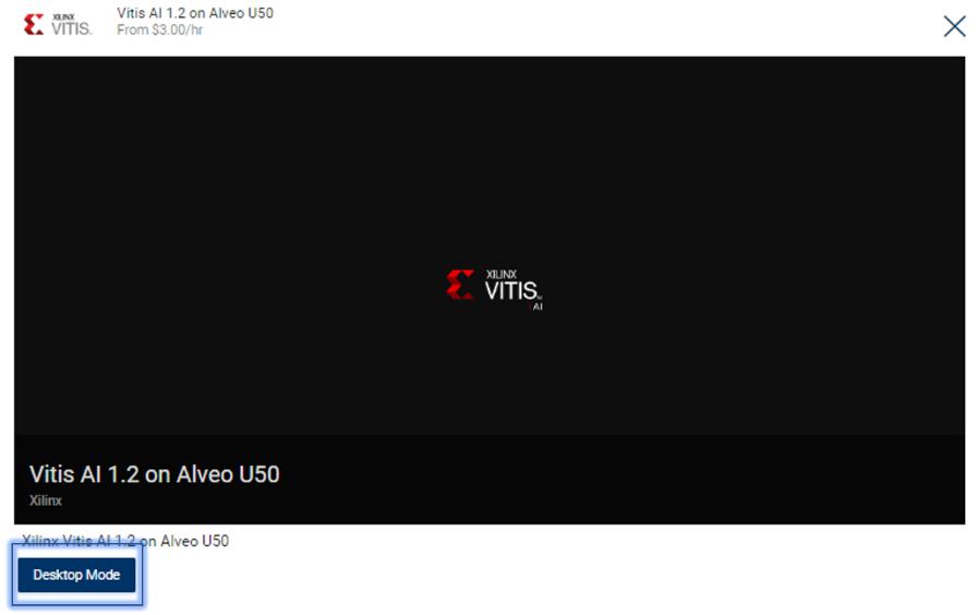

3.  Click on the ‘Desktop Mode’ button in the bottom-left corner of the next screen:
desktop-mode
4. Click on the ‘SUBMIT’ button in the bottom right corner of the next screen:

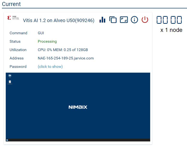

submit

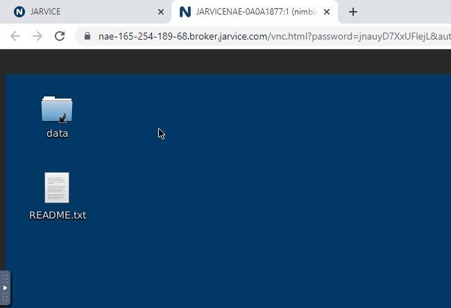

5. Wait until the desktop thumbnail image is visible (might take a few seconds) and then click anywhere inside the desktop thumbnail image to open it in a separate browser tab…On the Nimbix desktop, you should see a folder called ‘data’ and a README.txt – you can ignore the README.txt and follow the instructions in this article.
readme.txt
jarvice.nimbix

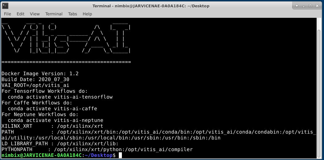

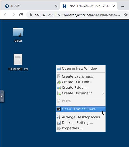

6. Open a terminal from the Nimbix desktop by right-clicking and selecting ‘Open Terminal Here’ from the context menu:
open-term-here
7.  The terminal will open and you should see the Vitis-AI banner - this indicates that we are already in the Vitis-AI CPU Docker container:
vitis-ai-cpu

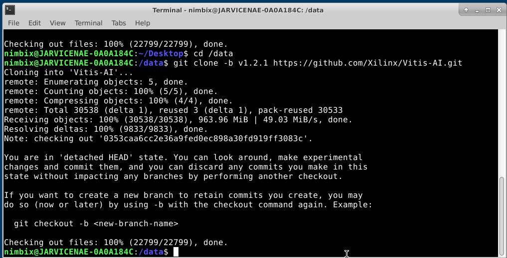

8.  Now we need to clone the Vitis-AI repository. As of time of writing (August 2020) Nimbix supported Vitis-AI version 1.2.x  so we must be sure to clone the correct tag. In the terminal, enter the following commands:
    $ cd /data
$ git clone -b v1.2.1 https://github.com/Xilinx/Vitis-AI.git
Note that ‘data’ is your personal data folder and all contents will be kept even if you log out of the session.
terminal-nimbix

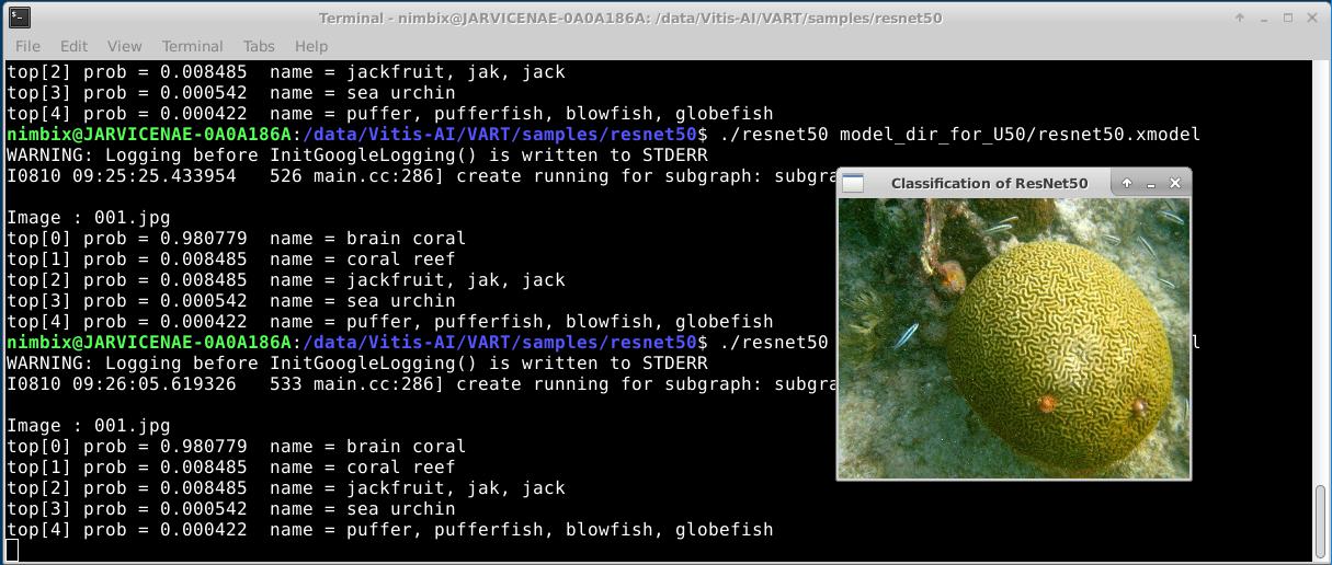

If everything has gone smoothly, you should see something like this:
jackfruit
Congratulations, you have successfully set up the Alveo U50 on the Nimbix Cloud service and run your first ML application!

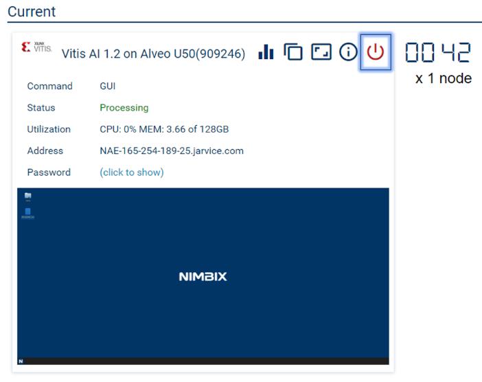

Finally, don’t forget to terminate the session by clicking on the ‘power off’ button on your JARVICE dashboard:
processing
