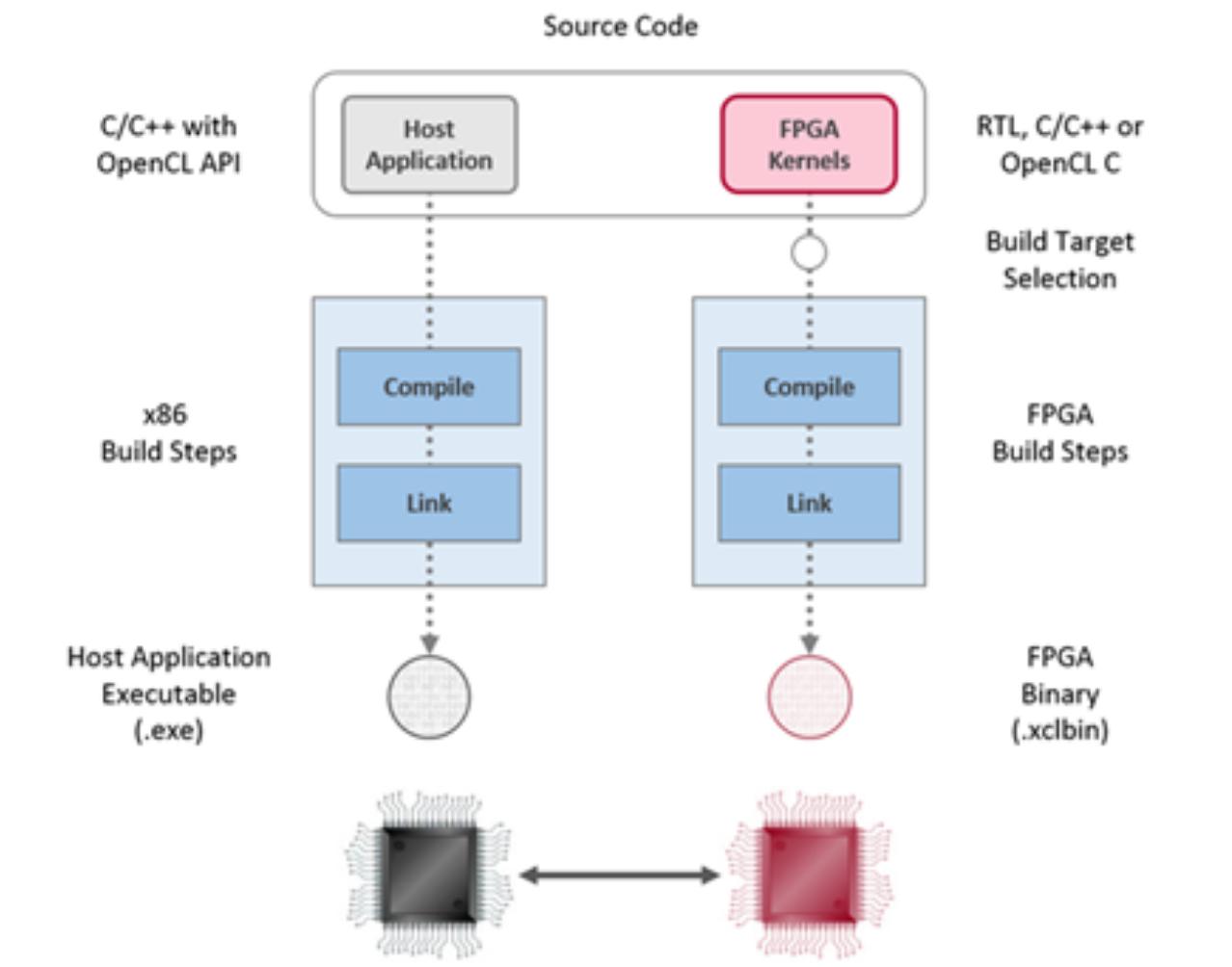

The Xilinx® Vitis™ unified software platform provides a framework for developing and delivering accelerated, heterogenous compute applications based on industry standard programming languages. The host application is written in C/C++ with OpenCL API calls.  The host code offloads the application's compute intensive tasks to be accelerated in the Programmable Logic within a Xilinx FPGA/SoC, or even within the AI Engines in our new Versal™ ACAP devices. The host code can run on an x86 processor and interface with the acceleration kernels running within a Xilinx FPGA over the PCIe bus. An example of this type of acceleration platform is one or more of the Xilinx Alveo™ cards running in a Data Center Server. In the new Vitis unified software program, the host code can also run on the ARM processor with our Zynq® UltraScale+™ and Versal devices and can interface with the acceleration kernels running within the Programmable Logic via the AXI bus interconnect. This type of acceleration platform could be one of the Zynq UltraScale+ development platforms, such as the ZCU102 or ZCU104 cards, or a customer can develop their own Zynq UltraScale+ card that is tailored to their exact platform acceleration needs.
The Vitis tool allows the user to develop acceleration kernels in several different languages- C/C++, OpenCL, and RTL code. Kernels developed with C/C++ or OpenCL are compiled with the Vivado High Level Synthesis (HLS) tool. Kernels that are developed with RTL code are compiled and packaged via Vitis tool packaging utility. There is also an RTL Kernel Wizard available that greatly simplifies this RTL packaging process. The Vitis tool makes it easy to combine/link the individual acceleration kernels together into one accelerated application regardless of the language(s) used to develop them. This article focuses on the process used to integrate optimized RTL Kernels into an accelerated application.
Software/Hardware Build Process within Vitis

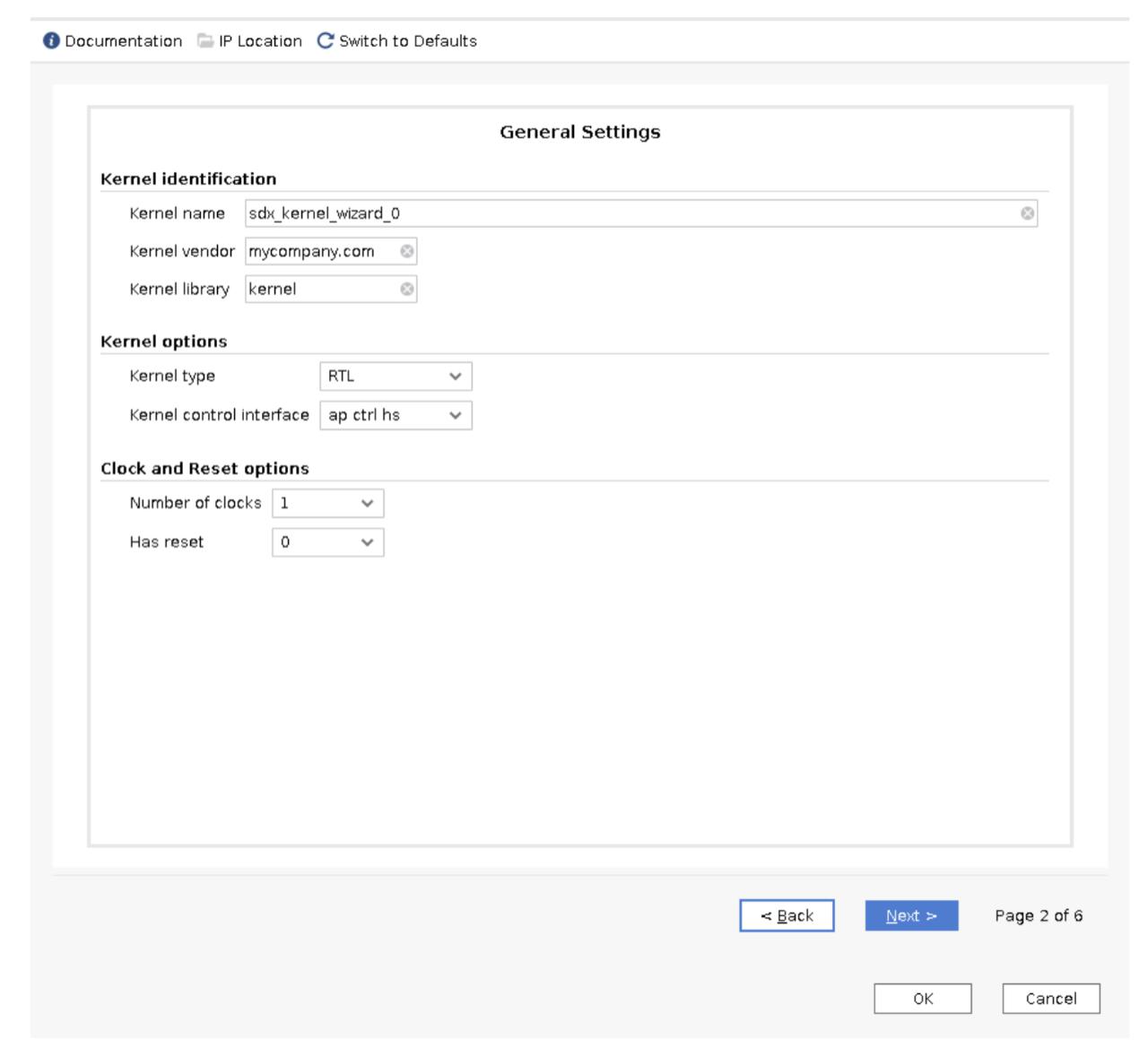

RTL Kernel Wizard
The RTL Kernel Wizard is a tool that helps automate the steps needed to ensure your RTL function is packaged into a kernel that can be successfully integrated into Vitis. This tool can be launched either from within Vitis or from within the Vivado IDE. It is recommended that the wizard be launched from the Vitis tool since this method provides a more seamless experience by automatically importing the generated RTL Kernel and example host code back into the Vitis tool once the kernel is generated
The RTL Kernel Wizard has the following high-level features and capabilities:
Allows the user to enter information about their RTL Acceleration Kernel through a series of GUI screens.
  • User enters general information like kernel name, number of clock ports
General Settings

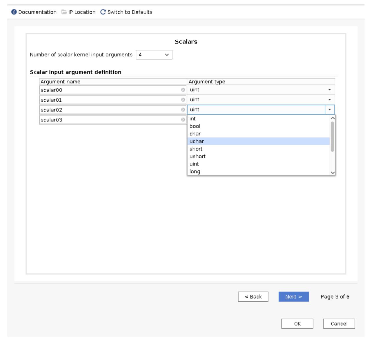

  • User enters information about the scalar arguments (name and type) that are used to pass control information from the host software to the kernel.

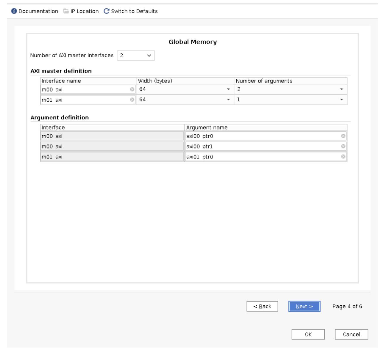

Scalars
  • User enters information about the kernel's AXI4 Master interfaces- number of interfaces, interface name, interface width, number of arguments associated with each interface, and argument names
Global Memory

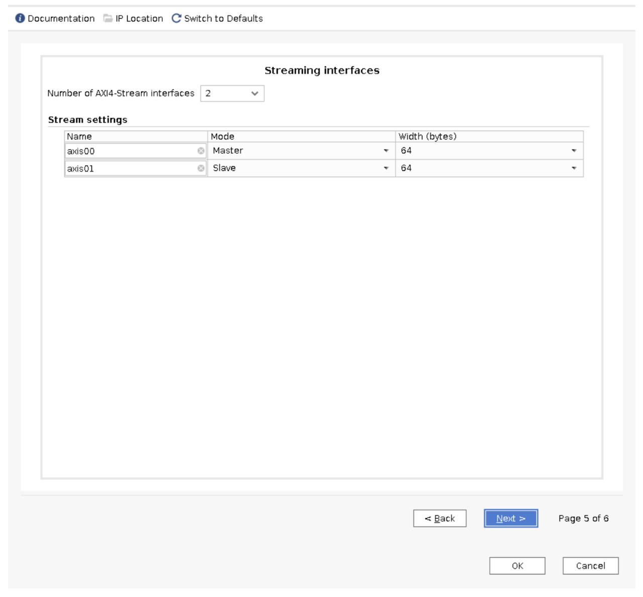

  • User enters information about the kernel's AXI Stream interfaces- number of interfaces, interface name, interface mode (master or slave), and interface width.
Streaming Interfaces

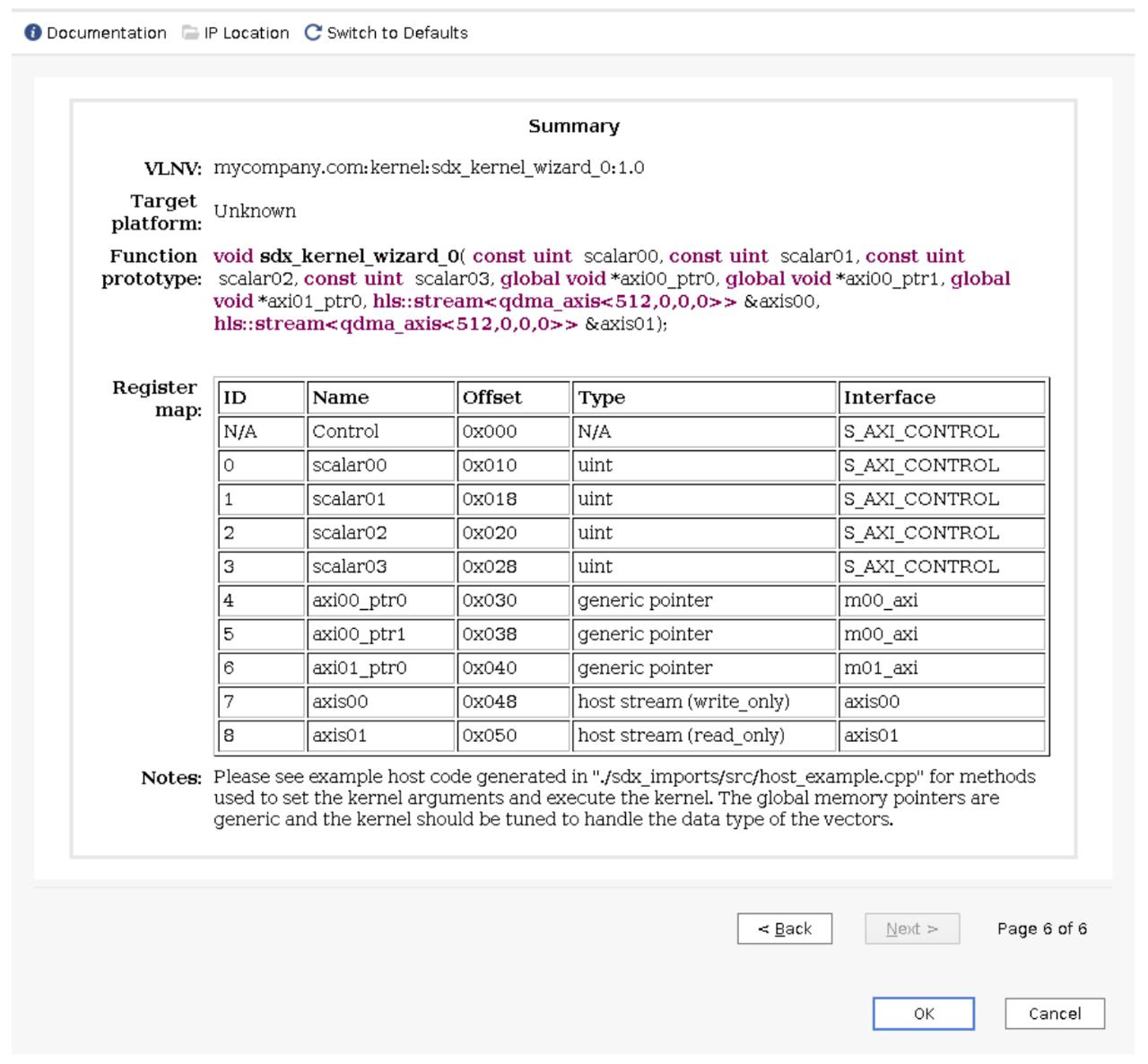

  •  After the user enters all information, a summary screen is provided that allows the user to check entries for correctness before generating the kernel.
Summary

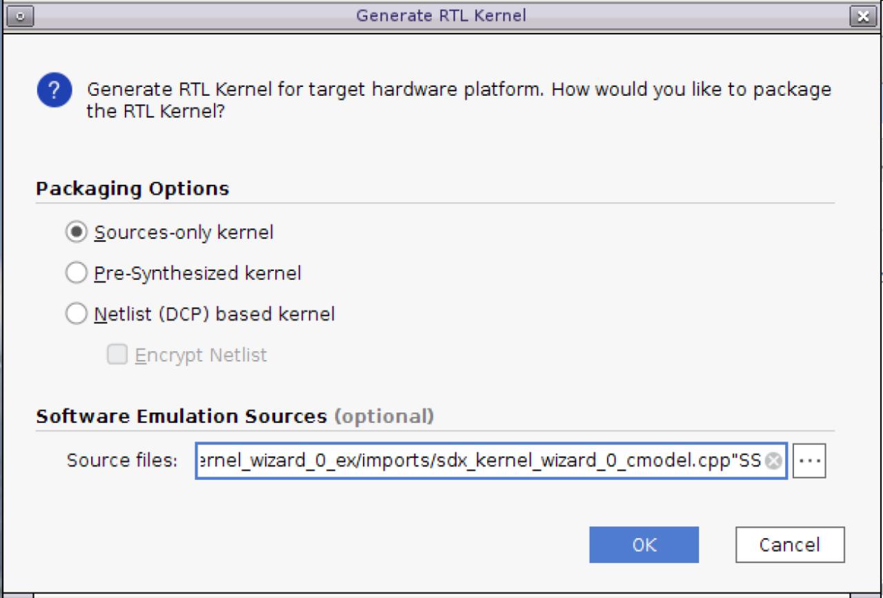

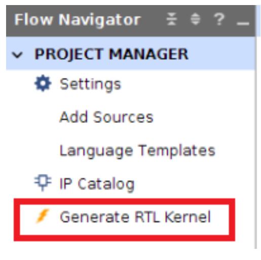

After the RTL Kernel has been designed and verified within Vivado, the final step is to package the RTL Kernel for use in Vitis. This can be done by simply clicking on the "Generate RTL Kernel" menu option within the Vivado Flow Navigator window
Flow Navigator
The user has several packing options to choose from, including whether the user wants to package just the RTL Source files (the default option), whether they want to package the RTL Source and a cached version of the synthesized netlist, or whether they just want to include a synthesized netlist (or dcp file), which can be optionally encrypted. The user also has the choice to package a C++ simulation model for the RTL Kernel if one is available. If so, this C++ model can be used to run Software Emulation within Vitis. If not, then simulation within Vitis is limited to Hardware Emulation, which is accomplished by running the RTL Kernel source files in an HDL simulator. This is a much more accurate simulation than Software Emulation, but also runs much slower.
General RTL Kernal
Once the above options are selected, the user can click OK to generate the RTL Kernel object file (.xo file). If the RTL Kernel Wizard was launched from the Vitis tool, as recommended above, then the RTL Kernel object file and the example host code are automatically imported into the source folder within the Vitis tool. At this point, the user can run Software Emulation of the Host Code and the RTL Kernel (if a C++ model of the RTL Kernel is available), run Hardware Emulation of the Host Code and RTL Kernel, and/or build the system, which generates the executable host code and an FPGA binary image which can be downloaded, run, and verified on a hardware platform. This hardware platform could be an Alveo card plugged into an x86 server or a Zynq  UltraScale+ based platform. Detailed steps on how to run Software/Hardware Emulation and how to build the system can be found in the Vitis User Guide.
