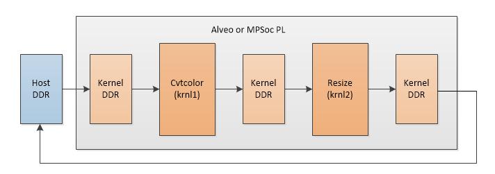

Overall dataflow of acceleration kernels is done in two ways for this tutorial.
(1)   Kernel to Memory (K2M2K) dataflow:
Host memory (image) -> kernel memory -> Vitis Vision cvtcolor ->  kernel memory -> Vitis Vision resize -> kernel memory -> host memory (see Figure 2)
Figure 2 - Diagram of Kernel to Memory (K2M2K) dataflow

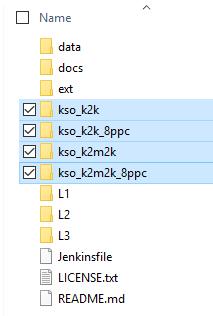

Makefile Flow
Figure 3 - Diagram of Kernel to Kernel streaming (K2K) dataflow
Figure 4 - Makefile flow - Reference design directory structure (Added to Vitis Vision Library location)
(A)   Alveo - Kernel to Kernel Streaming (K2K) and Kernel to Memory (K2M2K):
Files located on Github  <<add link here>>
Directory structure for each dataflow:
image                 (example jpg files)
data                     (reference png/jpg files)
src                        (all source code)
bld_hw               (implementation directory, Alveo)
bld_mpsoc         (implementation directory, MPSoC/ZCU102)

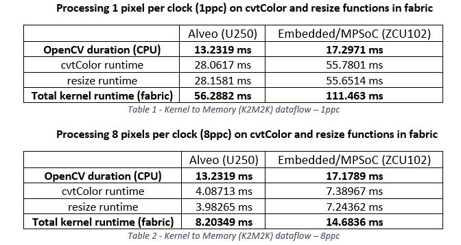

Results and Conclusion
This section gathers the runtime results after running the k2m2k and k2k dataflows on both targeted platforms, Alveo and MPSoC.  During the execution of the application, the host first runs the video functions using the OpenCV library which is an optimized software-only version without fabric acceleration; this runtime is logged as “OpenCV duration (CPU)” in Table 1 to 4 below.  Then the host runs the same video functions using the Vitis Vision Library targeting the acceleration platforms, the cvtColor and resize functions being executed in FPGA fabric.  These runtimes are reported as “Total kernel runtime (fabric)” on the last line of Table 1 to 4.  You will see two more runtimes in Table 1 and 2, one for cvtColor and one for resize; when running the Kernel to Memory application, it is possible to get those independent runtimes from the Host.  However, for the Kernel to Kernel streaming, it is not possible to get the intermediate runtimes because the execution of both kernels happens concurrently in the fabric, thus no runtimes can be extracted, and they won’t be reported in Table 3 and 4.
(1) Kernel to memory (K2M2K)
kernel to memory (k2m2k) dataflow
Figure 6 Application Timeline for kernel to memory, K2M2K
(2)  Kernel to streaming (K2K)
kernel to kernel streamng (k2k) dataflow
Figure 8 Application Timeline for kernel to streaming, K2K
The very first observation is the above results may not be what was originally intended when comparing to the host processing time.  The OpenCV processing time of the resize and cvtcolor are less than the acceleration time of the kernels in 1 pixel per clock (1ppc) mode.  These results are expected since we are only processing one frame in the example.  Next observation, the above results show that streaming kernel to kernel cut the execution time in half, which is a great improvement, however the fabric runtime in 1ppc is slower than running the same functions on the host CPU.
When running the kernels in 8ppc mode we can exceed the performance of the CPU based OpenCV function even when processing one frame.  Keep in mind that the host runtime can vary depending on workload and system performance (note the differences for Alveo board between k2mk2 and k2k).  The kernel runtime is fixed since it is dedicated hardware.  Three important observations here for the 8ppc mode: (1) k2m2m or k2k show 7x runtime improvement over the 1ppc mode in fabric, (2) the fabric runtime is faster than host execution (17-60% for k2m2k, 2x for k2k), and (3) the overall improvement achieved with 8ppc and k2k is roughly 14x compared to 1ppc and k2m2k.
The current MPSoC architecture limits the PS-PL data widths to 128-bit (HPC interface) and could potentially impact the overall streaming data flow from host memory to kernel memory; the Alveo doesn’t have the same limit and can match the 512-bit AXIS through the whole dataflow.  In our specific case, this limitation has no impact on the runtime, the total data bandwidth remains below the maximum supported by a single HPC interface, however something to keep in mind for other acceleration projects.  Vitis and HLS take care of the data packing to efficiently transfer the pixels via the 128-bit data interface: two consecutive beats per data are required to transfer 192 bits (3 colors * 8-bit/color * 8ppc = 192 bits).
At the time of this article we have only completed a single frame.   To show the real advantages of the acceleration kernels in OpenCV using the Vitis Vision Library, there are two ways of doing this.  The first is when you have many functions that are chained back to back.  A CPU in this scenario must process each frame serially as it goes through the OpenCV functions manipulating the single frame.  In the acceleration kernel space, the frame being processed by the first kernel is then immediately passed along to the next kernel during execution (see Kernel to Streaming timing diagram above, Figure 8).  The more kernels in the acceleration domain the more parallel processing occurs.  You could also replicate the chain of kernels multiple times to process multiple frames at a time.  Other functions in the OpenCV library can be more CPU intensive which would allow for a higher performance gain in the fabric.
The second way to significantly decrease the kernel processing time is to buffer many frames in host memory and the transfer to the kernel space for execution.  This will keep the kernels processing continuously instead of waiting for a single frame being sent over one at a time.  In the end it all comes down to memory management and how to keep the kernels/pipe fully utilized.  You could also replicate the accelerated data path multiple times in the fabric which would allow multiple frames to be processed in parallel.
We are currently working on a design that will achieve the above enhancements.
