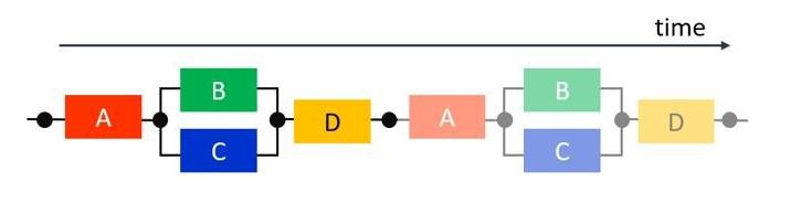

Often, compute tasks invoked one after another in the C code implement a “recipe”, i.e., one function produces data that the next one consumes and so forth. In this common producer-consumer scenario, tasks cannot be executed in parallel since data need to be ready before further processing can take place. Are we then forced into a linear model of execution? Fear not! A tool like HLS can, under some restrictions, assess the relations between data accesses (producer-consumer relations) and define a task graph on which parallelism and pipelining can be exploited.

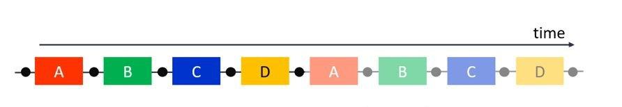

The following diagrams illustrate different overlapping executions for the simple example of 4 consecutive tasks (i.e., C/C++ functions) A, B, C, and D, where A produces data for B and C, in two different arrays, and D consumes data from two different arrays produced by B and C. Let us assume that this “diamond” communication pattern is to be run twice (two invocations), and that these two runs are independent.
A fully-sequential execution corresponds to the diagram in Fig. 1 where the circles represent some form of synchronization used to implement the serialization.
Fig. 1: Sequential execution (two runs)

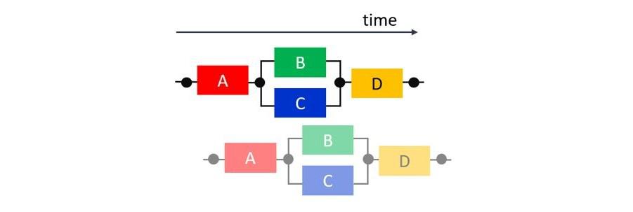

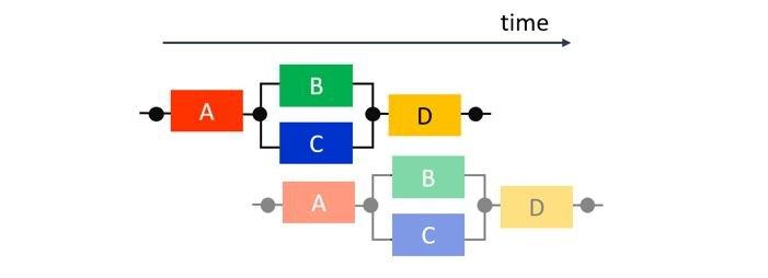

In the diamond example, B and C are fully-independent: they do not communicate, they do not access a shared memory resource, and if no sharing of computation resource is required, one can thus expect them to execute in parallel. This leads to the diagram in Fig. 2, with a form of fork-join parallelism within a run: B and C are executed in parallel after A ends, D waits for both B and C, but the next run is still serialized.
Fig. 2: Task parallelism within a run
Such an execution can be summarized as (A; (B || C); D); (A; (B || C); D) where “;” represents serialization and “||” represents full parallelism. This form of nested fork-join parallelism corresponds to a subclass of dependent tasks, namely series-parallel task graphs. More generally, any DAG (directed acyclic graph) of dependent tasks can be implemented with separate fork-and-join-type synchronizations.

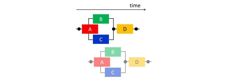

Let us go a bit further. So far, the previous execution pattern exploited task-level parallelism within an invocation. What about overlapping successive runs? If they are truly independent, but if each function (i.e., A, B, C, or D) reuses the same computation hardware as for its previous run, we may still want to execute, for example, the second invocation of A in parallel with the first invocations of B and C. This is a form of task-level pipelining across invocations, leading to a diagram as depicted in Fig. 3. The throughput is now improved, because it is limited by the maximum latency among all tasks, rather than by the sum of their latencies. The latency of each run is unchanged but the overall latency for multiple runs is reduced.
Fig. 3: Task parallelism within a run and pipelining across runs
Now however, when the first run of B reads from the memory where A placed its first production, the second run of A is possibly already writing in the same memory. To avoid overwriting the data before it is consumed, one can rely on a form of memory expansion, namely ping-pong memories (see hereafter).
Let us go even further. An efficient technique to improve throughput and reuse computational resources is to pipeline operators, loops, or functions. If each task can now overlap with itself, we can achieve simultaneously task parallelism within a run, task pipelining across runs, and pipelining within tasks, as shown in Fig. 4. The overall throughput of a run is further improved, because it now depends on the minimum throughput among the tasks, rather than their maximum latency.
Fig. 4: Task parallelism within a run, pipelining of runs, and pipelining within a task

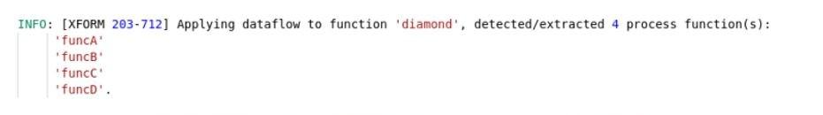

Let us now give a practical illustration of how the compiler implements overlapping executions such as those in Fig. 3 and Fig. 4, using the same “diamond” topology: Function A reads an input array vecIn of 100 elements and produces two arrays, one read by B, one read by C. Then B and C perform some intermediate computations and produce one array each, both read by D. Finally, D produces an output array vecOut of same number of elements. To get the behavior of Fig. 3 (task graph parallelism and overlapped execution across runs), we apply the HLS dataflow pragma on the function that contains the calls to A, B, C, and D. To ensure the most throughput within the tasks, we pipeline and partially unroll the loops in each subfunction with the HLS pipeline and HLS unroll pragmas.  The unroll factor of 2 is chosen to schedule two accesses per cycle and exploit at best the dual-port memories assumed by HLS on external connection for C arrays, i.e., here the ports of the “diamond” top function.
After running HLS C synthesis, the solution log confirms that the compiler was able to identify the processes, i.e., the communicating tasks with single producer-single consumer channels:
Fig. 6: Confirmation by HLS that processes were identified

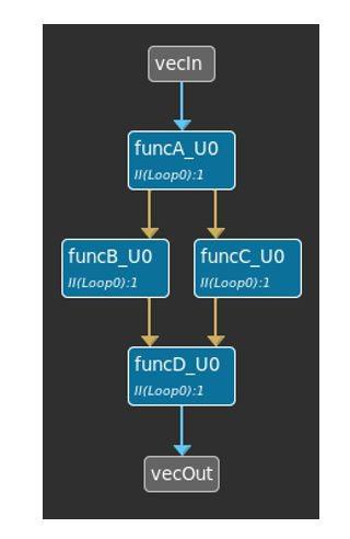

When a design uses dataflow, the Xilinx HLS GUI also provides a specific view depicting the extracted tasks and the connections between them, as shown in Fig. 7 below.
fig-7-1
Fig. 7: Dataflow viewer

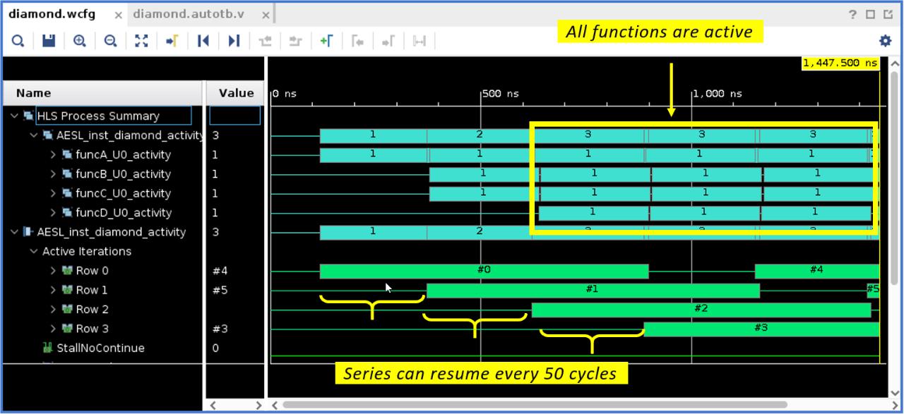

To further inspect the effect of dataflow, it is possible, during the HLS RTL/C co-simulation (CoSim), to select “wave debug”, Verilog, and the Xilinx simulator. The tool will then create specific dataflow waveforms to review. For our example, they look like this:
Fig. 9: Dataflow specific waveforms in Vivado simulator (launched from HLS)
As depicted in the “HLS Process Summary” upper section with cyan horizontal bars, initially only funcA is active, then funcB and funcC, then all are active. The “Active Iteration” lower section with green horizontal bars shows the 3 iterations coded in the testbench, each separated by about 50 clock cycles as expected.
