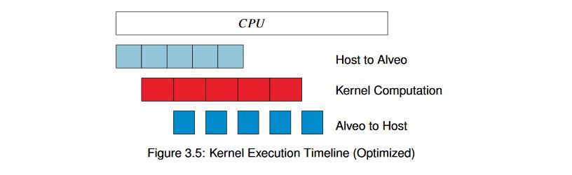

To that end we’ve actually been a bit tricky with our hardware design for the wide_vadd kernel.  Instead of just consuming the data raw off of the bus, we’re buffering the data internally a bit using the FPGA block RAM (which is fundamentally an extremely fast SRAM) and then performing the computation.  As a result we can absorb a little time between successive bursts, and we’ll use that to our advantage.
Remember that we’ve split our interfaces across multiple DDR banks, as shown in figure 3.3).  Since the PCIe bandwidth is much lower than the total bandwidth of any given DDR memory on the Alveo™ Data Center accelerator card, and we’re transferring data to two different DDR banks, we know we’ll have interleaving between the two.  And so, because we can “squeeze in between the cracks” as it were, we can start processing the data as it arrives instead of waiting for it to completely transfer, processing it, and then transferring it back.  We want to end up with something like figure 3.5.
Figure 3.5: Kernel Execution Timeline (Optimized)
By subdividing the buffer in this way and choosing an optimal number of subdivisions, we can balance execution and transfer times for our application and get significantly higher throughput.  Using the same hardware kernel, let’s take a look at what’s required to set this up in the host code.
