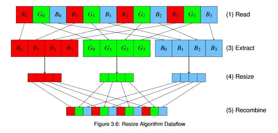

Let’s look at a very simple example: a bilateral resize algorithm.  This algorithm takes an input image and scales it to a new, arbitrary resolution.  The steps to do that might look something like this:
  1. Read the pixels of the image from memory.
  2. If necessary, convert them to the proper format.  In our case we’ll be looking at the default format used by the OpenCV library, BGR.  But in a real system where you’d be receiving data from various streams, cameras, etc. you’d have to deal with formatting, either in software or in the accelerator (where it’s basically a “free” operation, as we’ll see in the next example).
  3. For color images, extract each channel.
  4. Use a bilateral resizing algorithm on each independent channel.
  5. Recombine the channels and store back in memory.
Or, if you prefer to think of it visually, the operation would look something like figure 3.6:
Figure 3.6: Resize Algorithm Dataflow
For the purposes of this diagram we haven’t shown the optional color conversion step.
