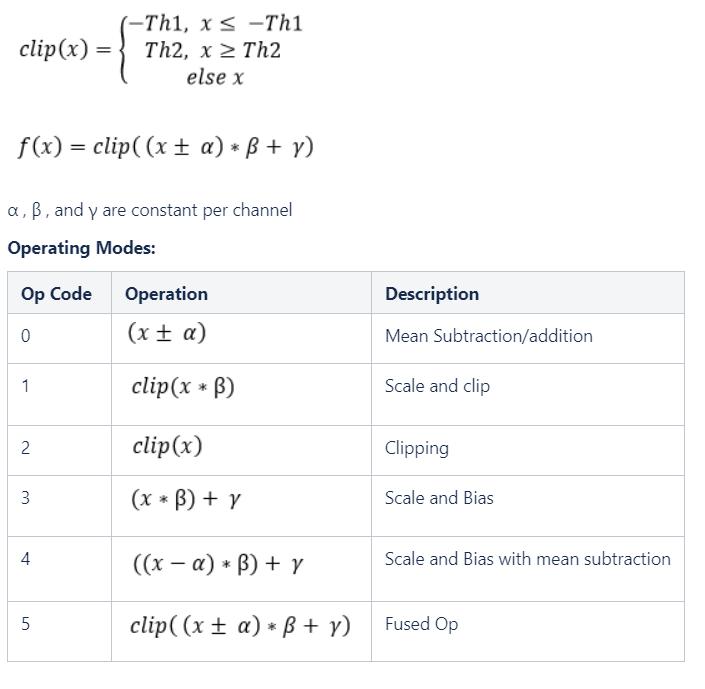

Custom Accelerator:
A custom accelerated function is created to do additional processing. It is implemented in manner that supports multiple operations.
Operating Modes
API:
    template <int INPUT_PTR_WIDTH, int OUTPUT_PTR_WIDTH,  int T_CHANNELS , int CPW,  int ROWS, int COLS, int NPC, bool PACK_MODE, int X_WIDTH, int ALPHA_WIDTH, int BETA_WIDTH, int GAMMA_WIDTH, int OUT_WIDTH, int X_IBITS, int ALPHA_IBITS, int BETA_IBITS, int GAMMA_IBITS,int OUT_IBITS, bool SIGNED_IN, int OPMODE, int UTH, int LTH>
void preProcess(ap_uint<INPUT_PTR_WIDTH> *inp, ap_uint<OUTPUT_PTR_WIDTH> *out,  float params[3*T_CHANNELS], int rows, int cols)

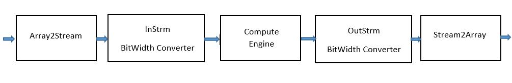

Data Flow:
Data Flow
Latency:
Number of cycles =   (rows*cols*T_CHANNELS)/(CPW*NPC)

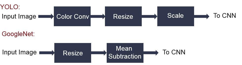

Preprocessing Pipelines
The figure below shows the preprocessing pipelines for GoogleNet and YoloV2
Yolo_Googlenet
All the functions in the pipeline have streaming interfaces, operate in dataflow, and use fixed point arithmetic.
Both pipelines were defined using C++
    void preprocessing ()
        xf::cv::Array2xfMat<INPUT_PTR_WIDTH,XF_8UC3,HEIGHT, WIDTH, NPC1>  (img_inp, imgInput0);
        xf::cv::resize<INTERPOLATION,TYPE,HEIGHT,WIDTH,NEWHEIGHT,NEWWIDTH,NPC_T,MAXDOWNSCALE> (imgInput0, out_mat);
        xf::cv::accel_utils obj;
        obj.xfMat2hlsStrm<INPUT_PTR_WIDTH, TYPE, NEWHEIGHT, NEWWIDTH, NPC_T, (NEWWIDTH*NEWHEIGHT/8)>(out_mat, resizeStrmout, srcMat_cols_align_npc);
        xf::cv::preProcess <INPUT_PTR_WIDTH, OUTPUT_PTR_WIDTH, T_CHANNELS, CPW, HEIGHT, WIDTH, NPC_TEST, PACK_MODE, X_WIDTH, ALPHA_WIDTH, BETA_WIDTH, GAMMA_WIDTH, OUT_WIDTH, X_IBITS, ALPHA_IBITS, BETA_IBITS, GAMMA_IBITS, OUT_IBITS, SIGNED_IN, OPMODE> (resizeStrmout, img_out, params, rows_out, cols_out, th1, th2);
