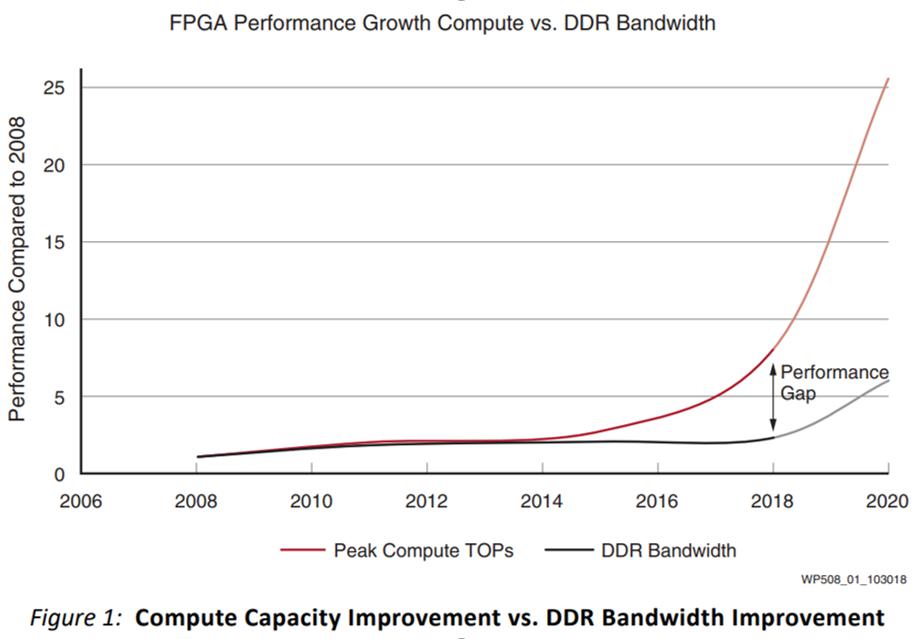

Many of today's workloads and applications such as AI, data analytics, and live video transcoding, and genomic analytics, require an increasing amount of bandwidth. Traditional DDR memory solutions have not been able to keep up with the growing compute and memory bandwidth-intensive workloads are becoming data movement and access bottlenecks. This figure shows the compute capacity growth vs traditional DDR bandwidth growth.
compute-capacity-improvement-vs-ddr-bandwidth-improvement

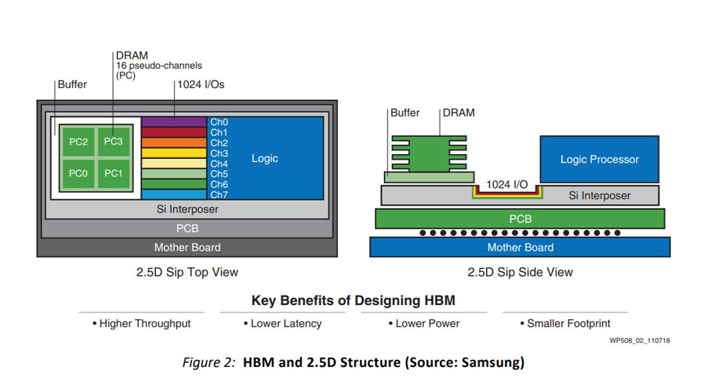

High-bandwidth memory (HBM) helps alleviate this bottleneck by providing more storage capacity and data bandwidth using system in package (SiP) memory technology to stack DRAM chips vertically and using a wide (1024-bit) interface.
hbm-25d-structure

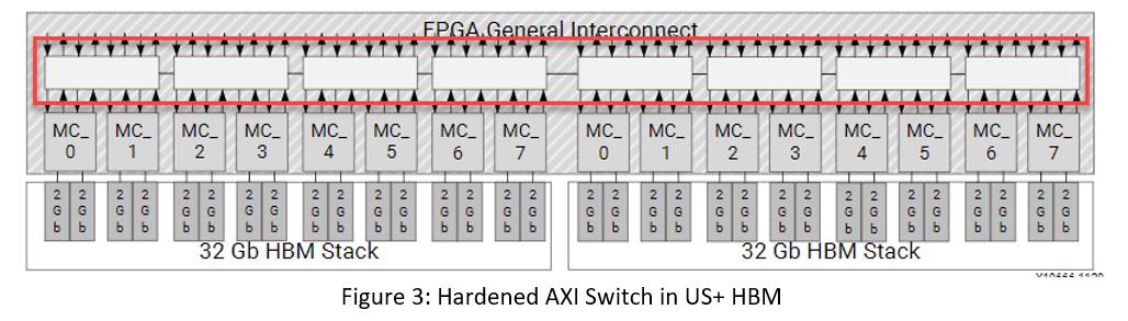

In VU+ HBM, there is a hardened AXI Switch which enables access from any of the 32 AXI channels to any of the HBM pseudo channels and addressable memory.
hardened axi switch in us+ hbm
There are many advantages to having a hardened switch such as flexible addressing and reduction of design complexity and routing congestion. WP485 does a good job of highlighting many of the advantages if you're interested. To enable flexible addressing across the entire HBM stacks the hardened AXI switch contains switch boxes broken up across 4 masters x 4 slaves.
hbm switch internal connections
This facilitates the flexible addressing but there is a limitation that can impact memory bandwidth. There are only 4 horizontal paths available which depending on which AXI channel is access which addressable memory location in the HBM stack can greater limit your achievable bandwidth due to arbitration.

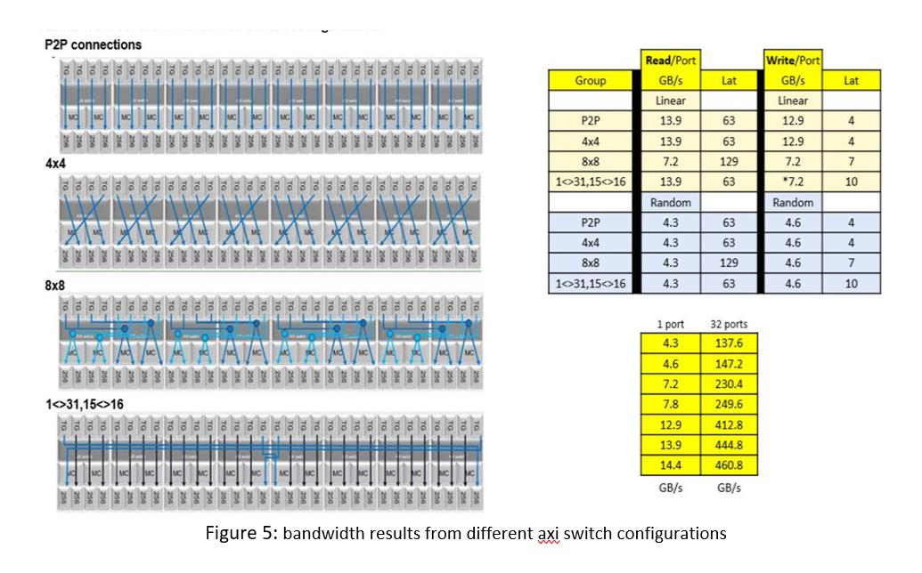

The figures below are taken from our VCU128 HBM Performance and Latency demo and attempt to highlight the bandwidth/throughput results from several different AXI Switch configurations.
bandwidth results from different axi switch configurations

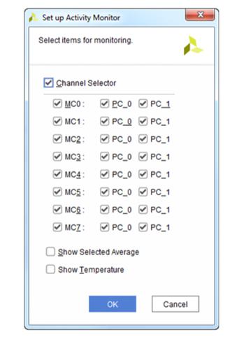

HBM Monitor

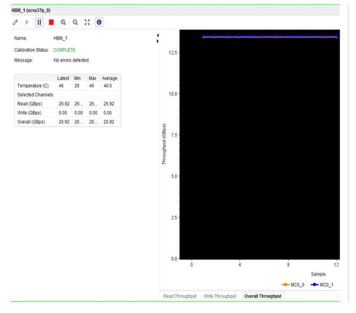

New to Vivado is the HBM monitor which, similar to SysMon, can display the die temperature of each HBM2 die stack individually. It also can display the bandwidth on a per MC or Psuedo Channel (PC) basis.
hbm monitor activity set-up window
For this test, read-only traffic is sent across all MC's. Only MC0 was added to the HBM monitor and it reports that the Read bandwidth is 26.92GBps. This is around 90% efficiency with a theoretical bandwidth being 30GBps
hbm monitor window within vivado hardware manager
To profile your hardware design and HBM configuration properly start with the default HBM settings and capture the read/write throughput as your baseline. Then regenerate new .bit files using each of and combinations of HBM MC options discussed earlier to determine which provides the highest throughput. Note, that how the AXI Switch is configured can also impact the HBM bandwidth and throughput and should be considered profiling as well.

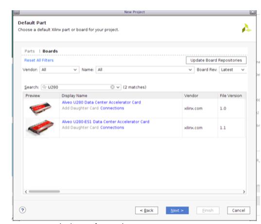

    1. Create new or open existing Vivado design
      1. Target the U280, VCU128 or whichever US+ HBM device being used
board selection for vivado project

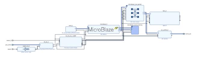

  1. Create Block Design

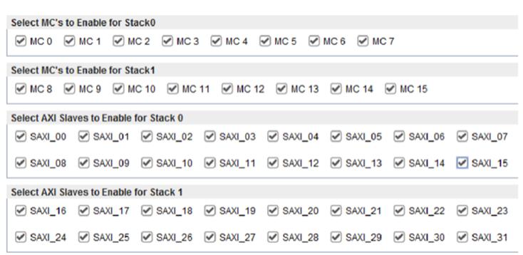

    1.     Add HBM IP core
      Note: Ensure project contains an IP Integrator (IPI) block design that includes HBM and Microblaze. This block design is what we refer to as the hardware design and to achieve near maximum theoretical bandwidth (460GB/s) for both HBM2 stacks you'll need to drive continuous traffic to all 16 available Memory Controllers (MC) via the AXI channels.
configuration view within hbm ip core
Add MicroBlaze, UART and any additional peripheral IP needed
Example hbm block design

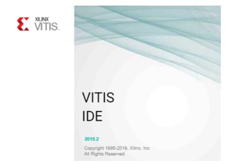

  7. Launch the Vitis tool
vitis

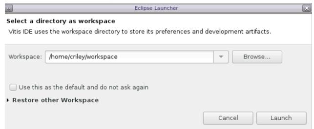

8. Select workspace
select-workspace

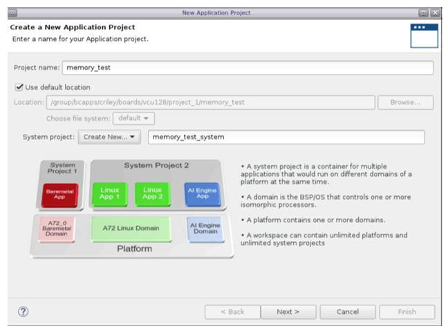

9. Create new application project and Board Support Package
create-new-space
10. Click Next, Select Create from hardware, click “+” and point to .xsa
11 Click Next, select CPU Microblaze, Language C
12. Click Next, select “Memory Tests” and click Finish
13. Build and run memory test on target
