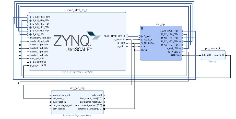

The first part of creating a Machine Learning Application is to create a hardware platform. This is accomplished using Vivado. Product Guide 338 (ver3.0) chapter 6 documents the instructions for recreating the ZU102 Targeted Reference Design (TRD) platform. Creating the Vivado project is as easy as sourcing a tcl file and then generating a bit file. It is important to note here that after the bit file has been created, then you will export the hardware description file (.hdf). This is accomplished in vivado by doing File->Export->Export Hardware, click Include the bitstream and finally take note of where it is saved because you will need this file later in the process.
This TRD project is simple and easy to reconfigure to different sized DPU co-processors. Once the block diagram is open (see figure below), just double click on heir_dpu and then double click on the DPU. Here you can see if is easy to change the architecture of the DPU.
zync-ultra-ps

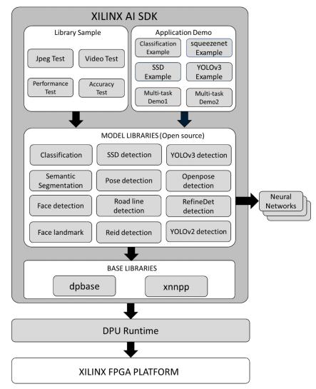

The Xilinx AI SDK is a set of high-level libraries and APIs built for efficient AI inference with the DPU. It provides an easy-to-use and unified interface by encapsulating many efficient and high-quality neural networks. This simplifies the use of deep-learning neural networks, even for users without knowledge of deep-learning or FPGAs. The Xilinx AI SDK allows users to focus more on the development of their applications, rather than the underlying hardware.
xilinx-ai-sdk-flow
The Xilinx AI SDK allows customers to quickly prototype and deploy their models to the DPU.  As seen above there are several AI applications and model examples to test and explore.
The AI SDK tool consist of 4 main sections:
  • Closed Source Base Level Libraries.
  • Open Source Model Libraries
  • Application Demos
  • Library Samples
The Base level Libraries provide an operating interface to the DPU and post-processing module of each model.  This allows the user to control, send and received data to the DPU.  The Open Source Model Libraries implement the neural network shown in the above diagram. The application demos illustrate the correct use of the AI SDK libs in an application and the Library samples provide an example on how to test and measure performance on the implemented model.

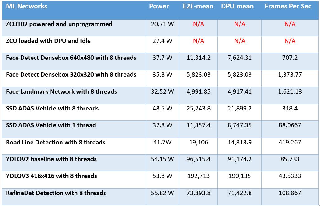

When developing ML applications for edge solutions it is important to understand the power consumption of the device and the performance you will see for the ML network you deploy. The following is a table of data gathered from the ZCU102 TRD that summarized the power and performance of various ML networks on this hardware platform.
Power was captured by using a Nashone Power energy meter with .1 W resolution.   By taking the power of an unprogrammed board, you can estimate the static power of your board and Xilinx MPSoC. By taking the power of a configured device after Linux has booted, this provides you a good estimate of the active and static power of an idle Processing subsystem. Finally, when running the various ML networks, you receive a total system power in which you could subtract off one of the two baselines to get good estimate of the power utilization of the ML networks.

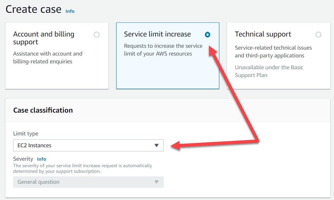

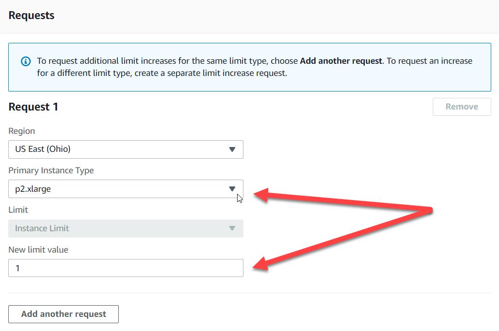

7. To run this tutorial, you will need the p2.xlarge instance.   This instance is not free. To enable this instance, file a support case with AWS using this link.
 http://aws.amazon.com/contact-us/ec2-request
8. Select the following options in your AWS case:
create-case
Note: the “Region” field can be different.
region

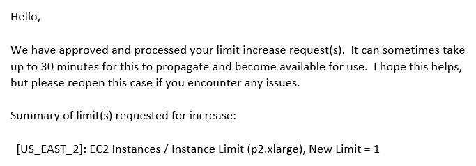

9. Amazon will approve your limit increase via email.
Example:
amazon

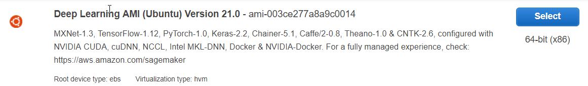

10. In the EC2 AWS console click on “Launch Instance”. Locate the below machine
deep-learning-ami
11. Next locate the p2.xlarge instance and click “Review and Launch”

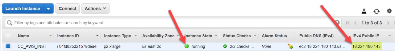

14. Click “View Instances” to see your AWS instance.
15. To start your instance, click on instance field, click on “Actions” button and select “Instance State” “Start”.  For the next step, copy the highlighted IP address (Ctrl C).

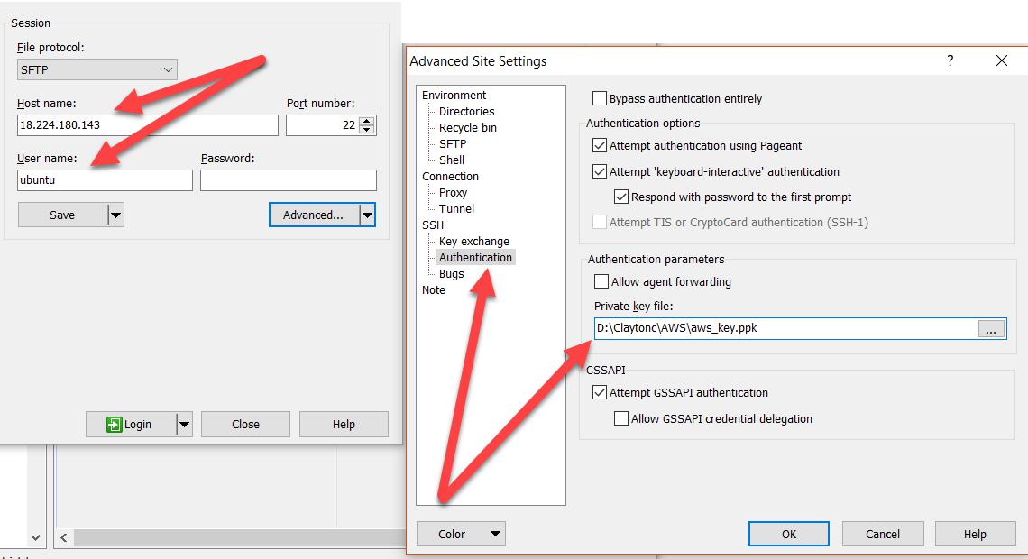

16. Now connect to your Instance with WinSCP and transfer the demo files.
  • Host name = your instance’s IP (highlighted in yellow)
  • User name = ubuntu
  • Password = (leave this blank)
17. In the advanced settings, point to your PPK file you created above in Steps 5&6.
advanced-site-settings
